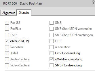

    Hi,
    please check the settings of your POSTMAN-TLD in DAVID administrator. The settings should look like this:
    If "Email-Rundsendung" ist unchecked, DAVID will send the whole job to the provider and probably your provider is not separating the individual jobs from each other. The result will be one email to all recipients, where everybody can see all other recipients.
    Putting the receiver in BCC as nordtech suggested is probably not what you want, although it would work. You want individual emails with the correct receiver in the To:-field, I suppose.
